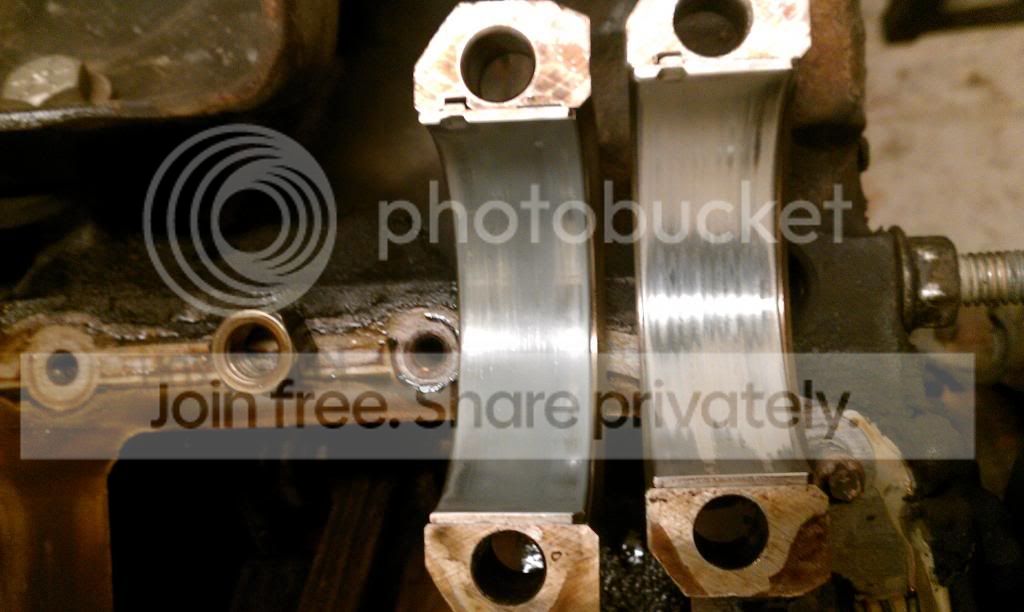

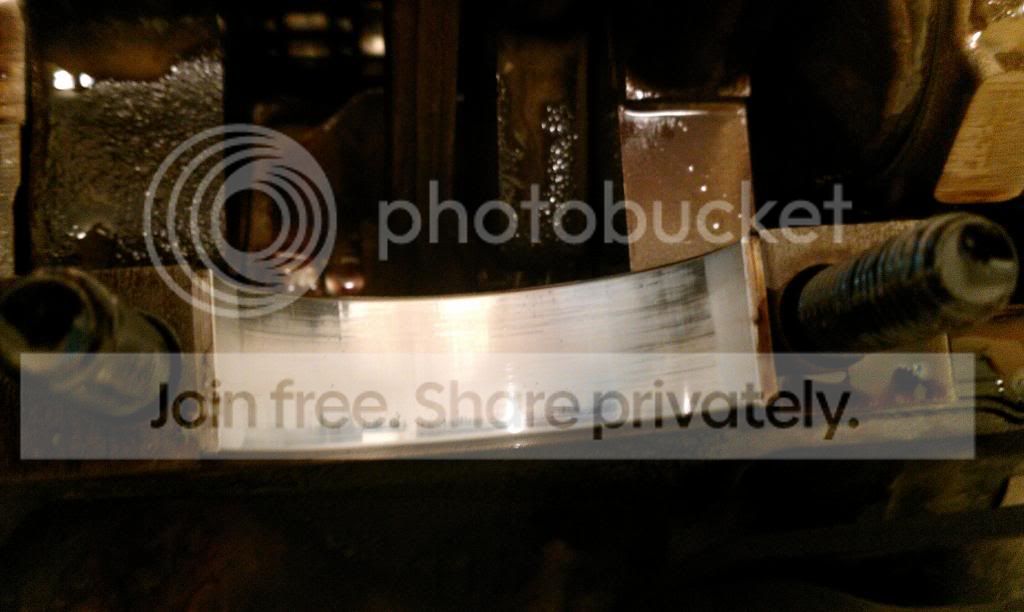

after looking at the bearings further it looks like they have some slight oil swipe. so im probably just going to replace them to be on the safe side. i was avoiding it because ive never replaced bearings and dont wanna jack up the clearances.

You have a micrometer set or are you going to use the string to set clearances? Since you have an automatic, thrust bearing clearance isn't an issue.

Sweet so I just gotta worry about journal clearances. I was gonna use plastigauge since I dont have access to a nice set if mics

The two worst are these. Number one main
#1&2 rods, #1 being the worst
And yes I figured string was plastiguage :)
