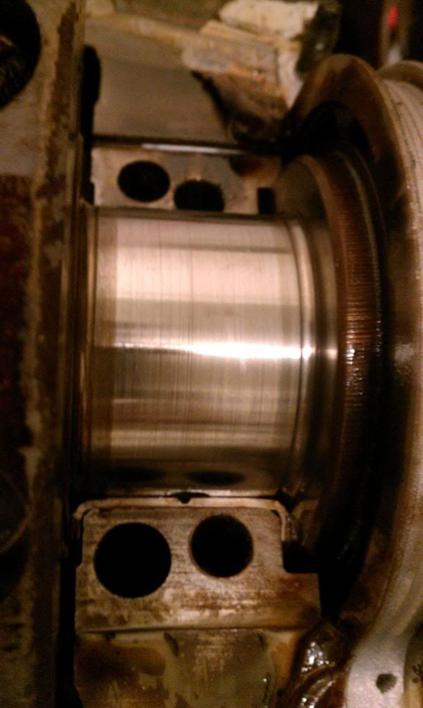

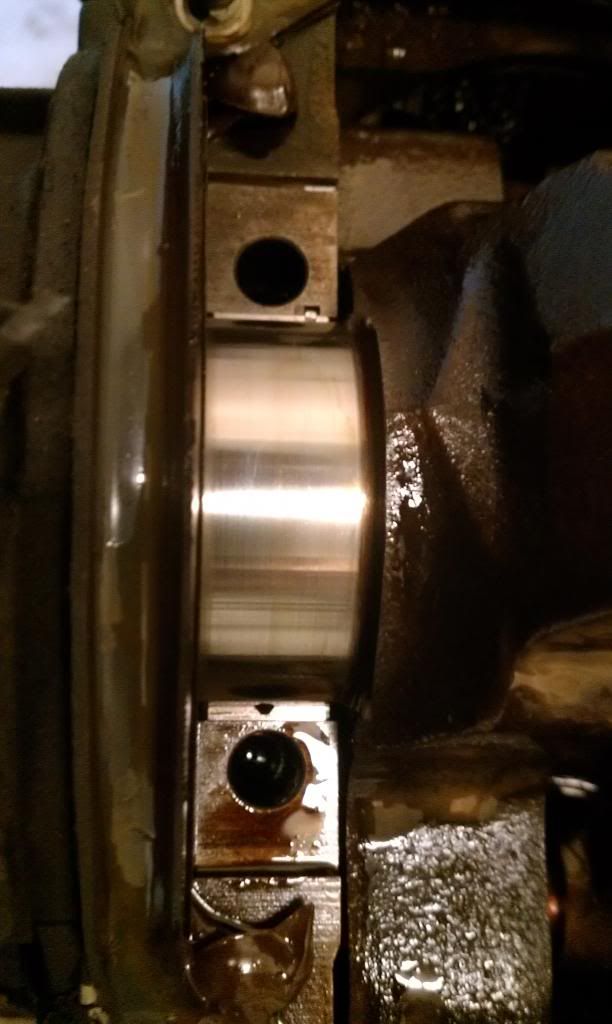

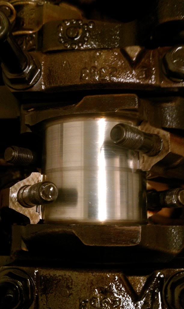

here are the mains, opinions? i think they look fine. working on rods right now

Put it back together, run it for a few miles with some cheap oil, then change the oil again.... IMHO.... Walmart has a jug of high mileage for around $15....

i had planned on atleast getting new bearings and rear main seal.

lesterl
Oct 10, 2011
2,597
MO
Are/were the bearings loose? They dont look bad, might throw a rear main in it while it is out, but I bet the rest was pretty tight.......
