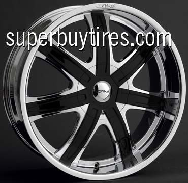

I need help with wheels for my 2008 Yukon Denali.
The first option is Lexani LX7
22X10, 6x139.7 +20mm offset. Would this fit the Yukon? or I need different offset?
The second one is Dvinci Volore
22X9.5, I don’t have much information about the offset and backspacing

It will stick out from the wheel wells. Do the Lexani's come in any other offset?
http://www.1010tires.com/WheelOffsetCalculator.asp
Link to pics of my wheels are in my sig. My wheels sit flush with the fenders.
Mine are 9.5" wide and 35mm offset. If you're going 10" wide w/ 20mm offset, yours will stick out 21mm more than mine (based on calculator above).
21mm = 7/8" (almost 1")

Yes the +20mm will stick out! Try to stick with a +30mm or higher!

Agreed! And stick with 6" of backspacing. The more backspace the closer the wheel will come to rubbing on the suspension or brake components.
