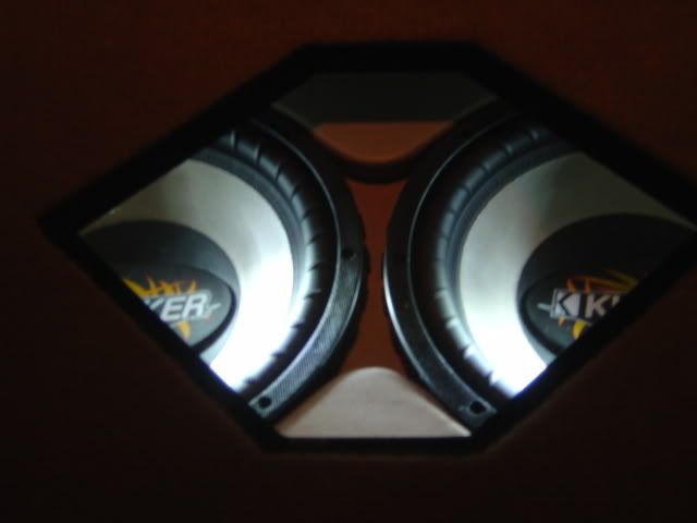

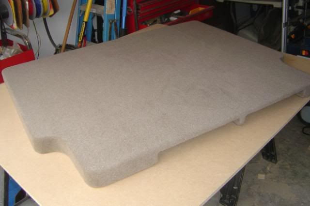

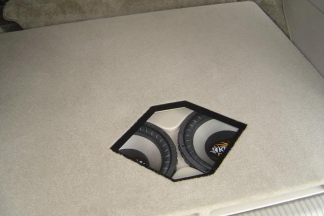

I welded together a box out of some aluminum panels (aluminum sucks to weld, btw) and angle iron. Then I mounted the MDF box inside of that. I sprayed rubberized undercoating around the outside of the enclosure and layed Dynamat on the inside walls of the aluminum panels. I got so caught up into the work that I forgot to take pics through some steps of the process.
The box only hangs about 13 inches from the bottom of the floorboard, which is less than the entire spare tire and spare mount together, so you can't even see it unless you kneel under the truck.
I have to pick up some material tomorrow to cover the new "floorboard", and then wire in the LEDs to the rear liftgate latch so they come on when the liftgate opens. So, I should have it done tomorrow or the next day, depending on my schedule.
