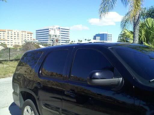

Thewes
Dec 14, 2008
Just got it out of the way. I really don't mind the screws poking out a bit.

There's an old thread here about removing the roof rack, with a picture of the results. I believe the author replace the screws with short stainless fasteners.
<edit> Oops, I see you've done it already. Looks nice IMO.

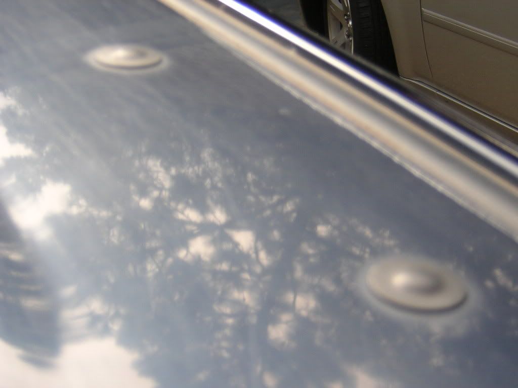

Rubber grommets. That's what the Police Pursuit Tahoe's use. Cheap. Flush. ...and keeps the water out!!

I've two Police Pursuit Tahoes, an 05 and 06. Both had grommets shown below. Easy, low cost, problem solved project.
tenmark262
Feb 6, 2007
39
I've had two Police Pursuit Tahoes, an 05 and 06. Both had grommets as shown below. Easy, low cost field-tested solution.
