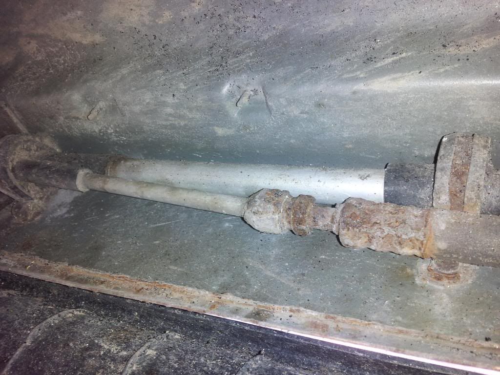

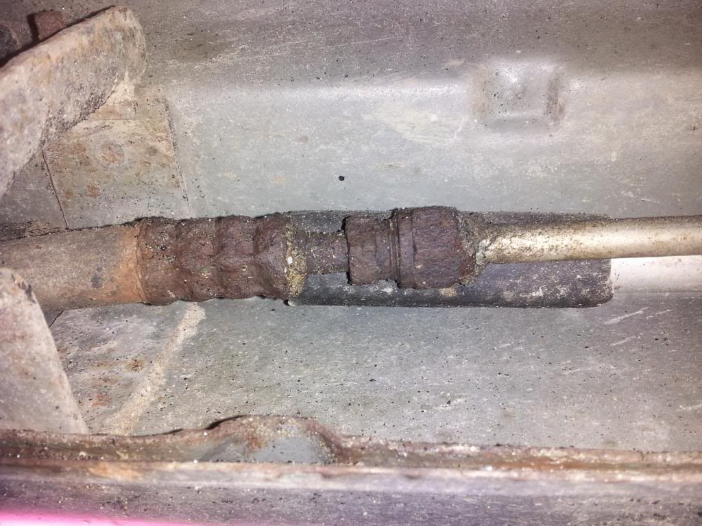

Hi Im new here and hoping I am posting in the right spot.
I have a 1999 Chevy Tahoe with rear ac and the lines to the rear ac are leaking freon from the lines running to the back. It looks like it is leaking from a adapter under the passengers side doors. Is there a easy fix for now since money is tight... Also would freon leak if I keep the rear AC off. From what I can tell there is no AC leak for the front AC.

Here are some pics

YUCK... You shure that is the source of your leak? Should be able to replace that section.

Pretty sure it is since when I filled it the gases came from right there only.... Looked like a cloud of smoke and could hear the hissing from there... the rest of the line looks clean too thats the only spot thats really dirty idk why though lol
