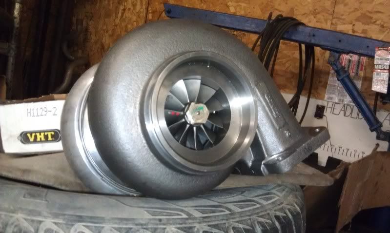

Well I just wanted to share a few pics, of my new setup. my old set up I had in my tahoe lastyear made right around 600 engine HP, on a stock escalade 6.0 engine and a 76 mm turbo on 8lb of boost, it blew up so I'm going bigger and better. Its a ERL built aluminum 408. they built it out of my old blown up ls2 that was in my tahoe a few years back. Its a turbo street package with compstar rods and crank, GFX rings and Wiseco pistons. I also made sure to get the best rod bolts, and main studs available.
Also this will have the KB turbo kit on it. I am selling my old t4 kit and 76mm, and srapping this big guy on. Its a t6 kit with the gt91 turbo. Although this is a street driven vehicle I think i want to do something radical with the down pipe, but still uncertain.

Welcome to the neighborhood!
WOW, what a set up. Should be good for some great numbers, let's see some pics of the vehicle that monster is going into, thanks for sharing your build with us!

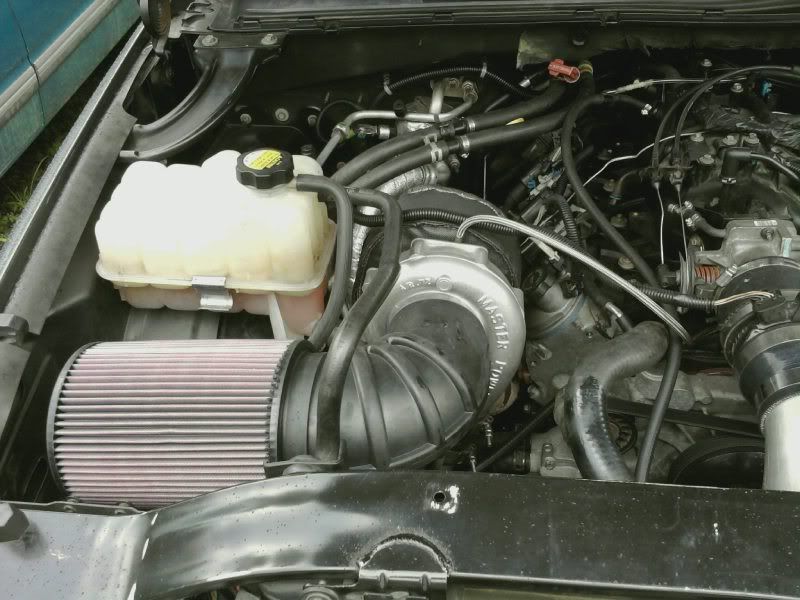

sure thing, and thanks! here's some from early 2011 , i alsohave some dyno video footage and other videos at scookscook on YouTube. thanks for checking her out!
