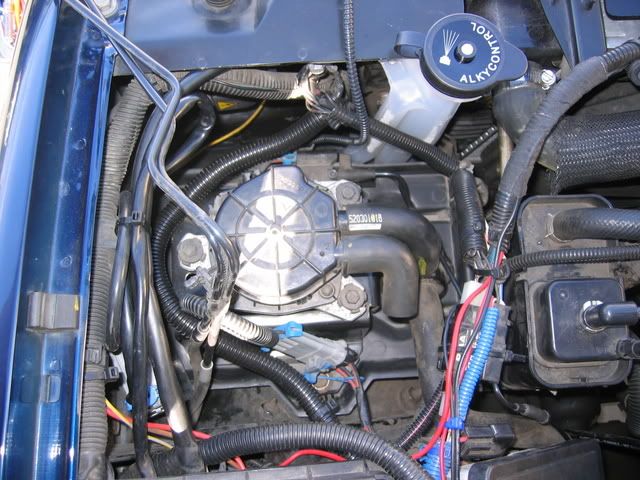

If you have air injection you would have an air pump above the windshield washer tank on the driver's side. Like this:

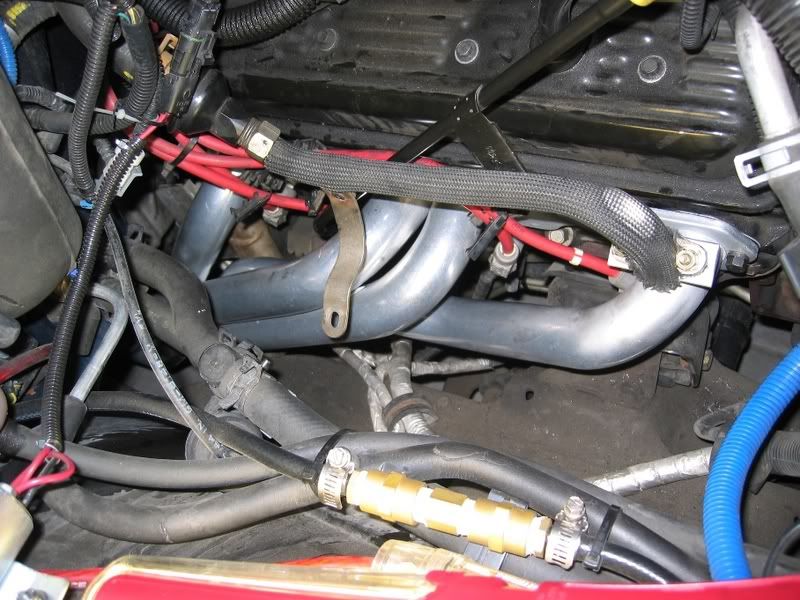

Also you would have tubes connected to the front of your headers like this:
