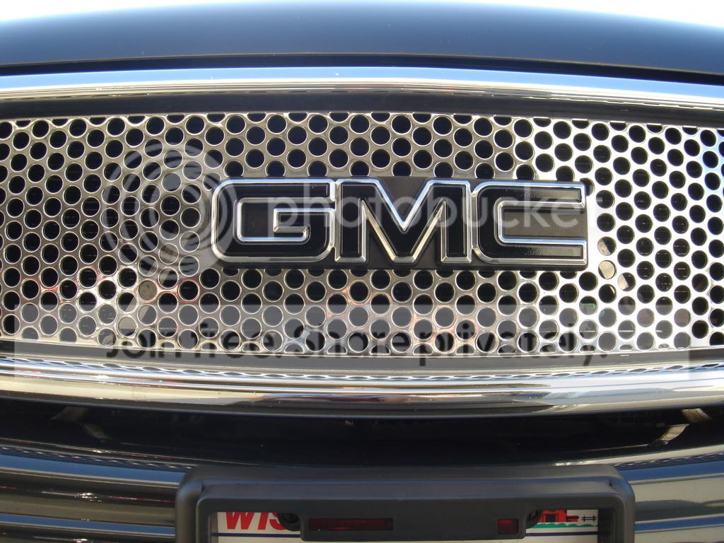

Need some help here,i am trying to find a blackout gmc emblem for the front of my yukon. Any help would be great.

what would you use to sand it, and then use a primer then black paint. See i live in Michigan and the winters are bad. That is why i am asking questions or just looking to buy one.
Pull the emblem from the grill if you can and sand it a few stages down before primer and paint. You could probably pay a body shop to do it for you or just get some good spray paint made.

I used 600 grit sandpaper and sanded the entire thing until it was a milky white color. Then I washed it and let it dry for a while. Masking if off was the hardest part but just take your time. I then put on 5 or 6 coats of black paint and 4 of clear and it turned out pretty good.
