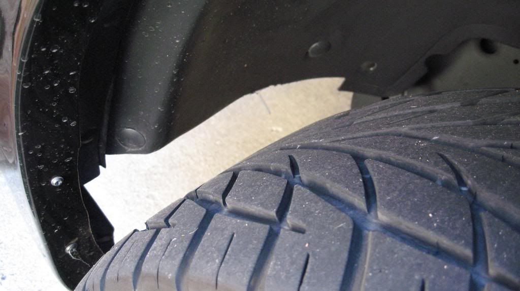

The picture with the green paint on the keys, mark the key according to the frame. Just run white out straight across the key and the frame. And YES, you will have to do alighnment afterwards. The alighnment will be altered once the keys are moved. And i honestly dont think your going to be able to tell a difference with lowering it that much. I was only going to get a 2/3 drop, but my friend convinced me ( pretty easily ) to go witht he 3/5.Glad i did it. Do your tires stick out the side of the truck. Maybe thats why you rub. Take some pics of your truck and where the rub, and maybe well be able to help a little more. Your on gmfullsize, huh?
Here's some pics I took of my tires:
Front right:
Front left:
You can see where the tire rubs, due to the window washer reservoir bottle protruding out.
Mark
Sep 21, 2008
40
Stockton, Ca
Just trim that part of the fender liner. not a big deal
Problem is, right behind the fender part is the white bottle which holds the window washer fluid. And that plastic is being rubbed from the tire as well. So I would have to move that entire white bottle and relocate it somewhere else.
