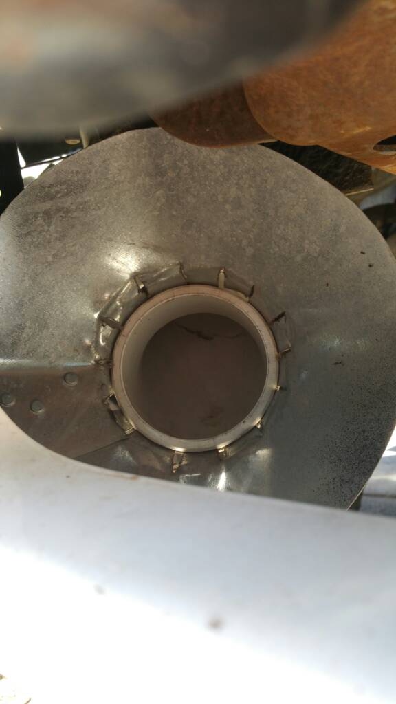

Hello everyone,I came across this thread and realized that its about something I already did to my 2002 Yukon denali about a year ago. I was looking at a volant cai with a scoop. But it was to pricey and figured I could do it my self. I used PVC tubing with a 90° elbow behind the tow hook. Very noticeable difference in acceleration and sound. But I put my own little twist on it. I know its probably gonna look funny to you. But I think it does the job very well of directing air to air filter.

2002 yukon denali add it my own little twist to it.
