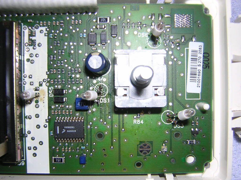

06 Tahoe here. Climate control back lights are out but the controls work fine...or er.. did.
Read some posts, bought two bulbs recommended by Radio Shack (12 Volts - 60ma), soldered them in - they worked but the others went out. Controls work.
Round two, bought eight bulbs (12 Volts - 50ma) per posts, soldered them in - they work but the controls stopped working and truck goes through theft lock cycle.
Unpluged it, truck runs great and has no theft lock problems. Somewhere along the line, I messed things up. Looks like I need a new unit.
Any tips,tricks,cheats for ordering the part online?

Can you see all the wires or where you soldering them on a circuit board. I normally just replace the control heads, I just dont have any of these laying around.
John
tenmark262
Feb 6, 2007
39
I soldered the bulbs directly to the board or at least to the wires coming out of the board.
Ojustracing
Dec 16, 2008
97
Bruston, NY

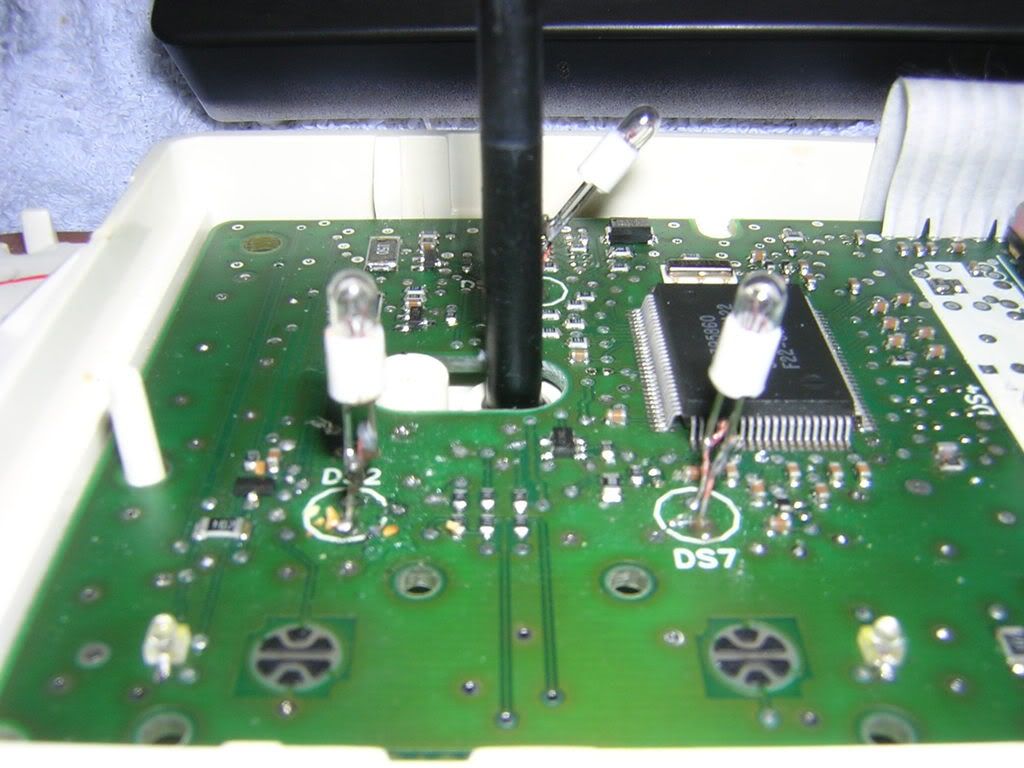

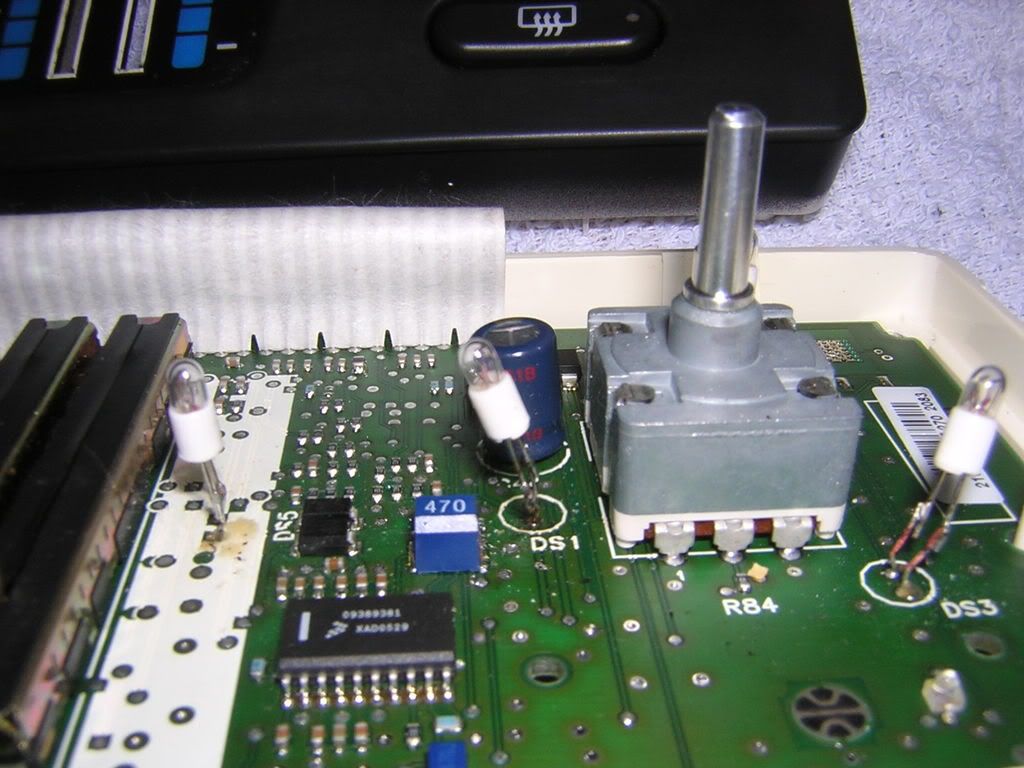

In theory you are just replacing burnt out lights. I wouldnt expect to have issue unless, on the board you are close to another circuit and providing power or ground to something that shouldnt. You might want to go back in double check that no solder is touching any other part of the circuit board. Let me see if I can get you an old control head from my friend at the dealer. He just grabbed me a few knobs off one.
John
tenmark262
Feb 6, 2007
39
Success!!!! Redid DS1 and cleaned up around DS6 and it works - dude, you're good. Now, what to do to get them blue. I destroyed all but three of the little blue condoms getting the bulbs off.

I wonder if blue paint would work. You have a blue cover cant be anyworse.
