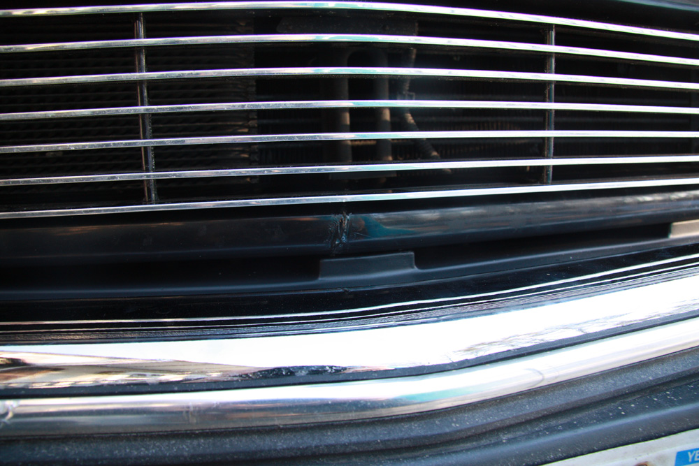

This is good stuff (I hope)
Can you see it?
Once it is sanded and painted over, you will never know anything even happened.

OMG, that is hideous. I wouldn't even drive that truck, much less be seen with it in person!!
J/k seriously. I think you did a good job. Cant really tell unless you're actually looking and being nit picky.
