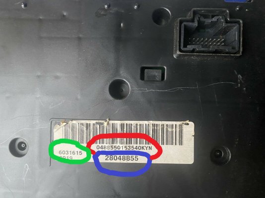

So am I correct that, re-programming a Tahoe to learn new key fobs was a 2007 year only capability? If not, what other year instrument clusters offered this? Also, the part number according to GMPartsdirect.com for the instrument cluster in a 2007 Tahoe LTZ with the 5.3 Flex V8 is 20970650. Searching that PN anywhere, using any method, all I get is a few references to dealerships who either say its out of stock or they offer a "repair service". I realize a 2007 Tahoe is 14 years old at this point but I NEVER see them up for sale on Ebay or anywhere else which seems very odd. Does anyone know WHY these instrument clusters are so damn hard to find? I've tried searching ebay but that is a huge pain in the ass. The part numbers in the listing almost never match the part numbers seen on the instrument cluster itself in the pics for the listing and when I search on those part numbers I can never determine what that cluster came out of unless the person listing the part states what vehicle they removed it from in the listing itself.
