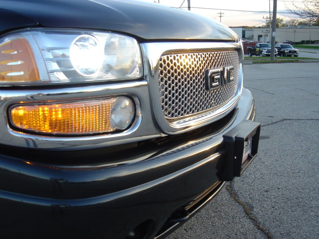

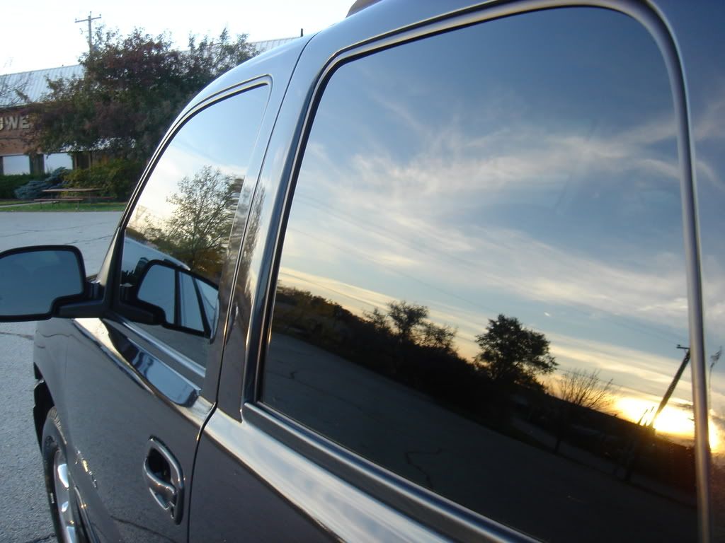

Last week I used clay on the yukon. Then I used the three step meguires stuff (paint cleaner, polish, and wax) and it turned out awesome. Took about 8 hours but well worth the time.
