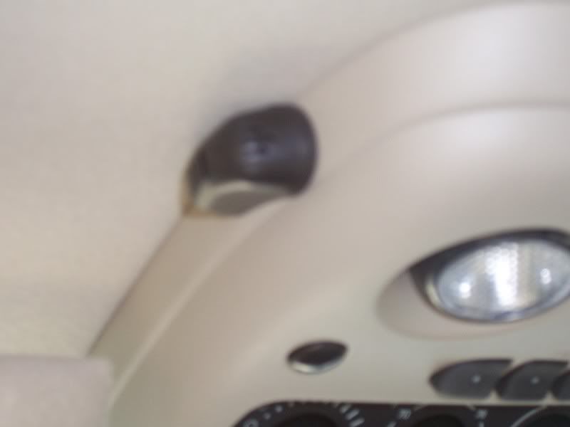

its stock, im not sure what it does, but theres another one on the drivers side back between the second and third row on mine. i would like to know too. i always wonder if thats a microphone that onstar monitors us with, or if it releases a toxic gas in the car if it senses a theft, or if its just some tweeters for the bose. :crazy:
DRIVER ONE
BETWEEN SECOND AND THIRD ROW.

That is actually the sensor for the climate control. The speaker I am talking about is mounted on the side of the overhead console. I will try to get some pictures posted today.

If you have a Verizon phone, you just add a line to your existing account for $10 /month and share the minutes from your original plan. You use the onstar button just like the onstar phone, but it works through your cell. The small mic on the overhead console is the mic for that. The small speaker looking thing over your head in teh drivers seat is the ambient temperature sensor for your automatic climate control. It is what pulls in small amounts of air and checks for the interior temp of teh car for the automatic climate control to work. It will inevitably go bad and start to make a humming sound. Just had this problem with mine!
