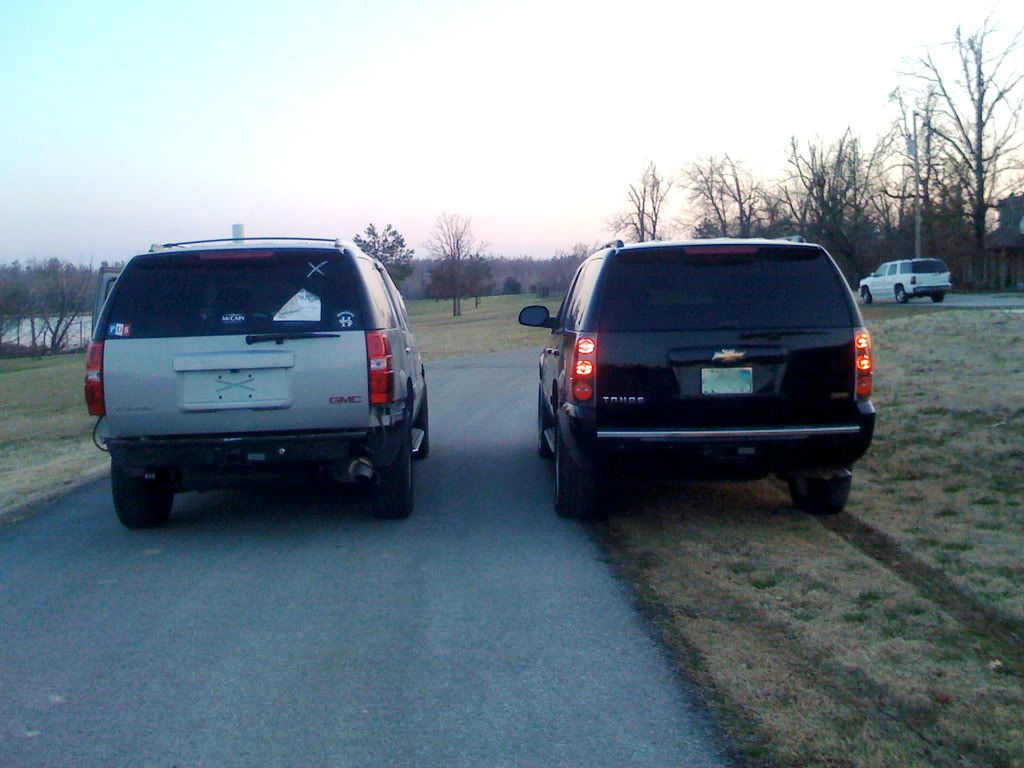

I actually got it off! It has 3 screws on each side under the car, you have to feel for them. Then I found out that the reverse sensors are plastic-tied to the tabs of the pad, so I had to cut those and mess with the tabs until they came up, and put the Denali's pad on, put it all back and voila:
Your Tahoe looks better, debadge it and get a hitch cover though! :)

Yeah I made a photoshopped version of that picture with the Hoe debadged, I liked it :]
