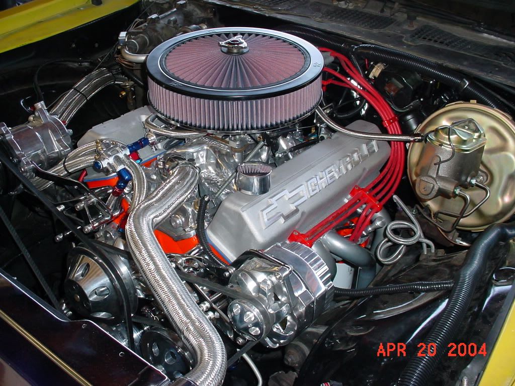

I had the MSD ignition wires on my 71 RS Camaro, when I had it.
