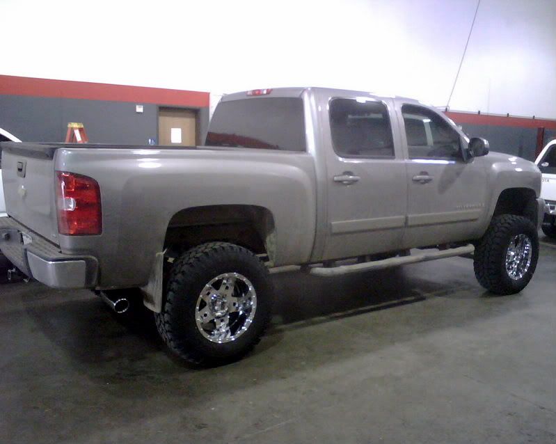

I paid $140 for my 20s in gloss, should be cheap for smaller wheels but I got a pretty good deal
Bought the wheels off the guy, I did this to his truck and he sold them to me for cheap
