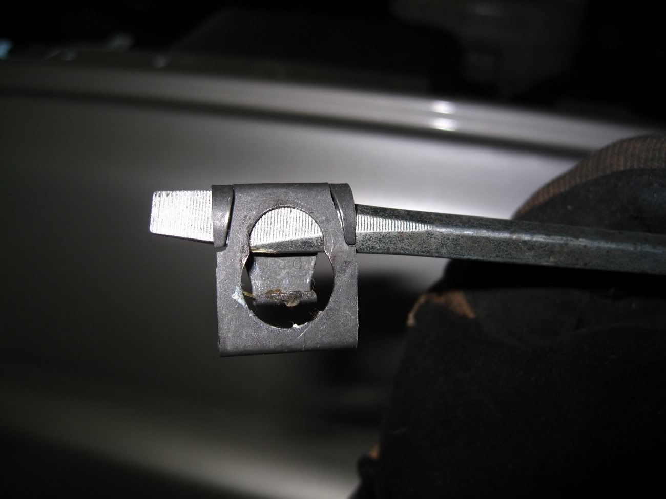

attachment.php
This is the one that I lost.
I'm pretty sure this is the one I picked up today.
So...which is the right one? And how do I install it? Do you just have to press it on there or is there some way to twist it?

Pin goes in big hole, press clip onto shaft and slide towards small hole, should snap in place...... Just like some of the clips on the TBI..... I have a 95 with the JB5 also.....
