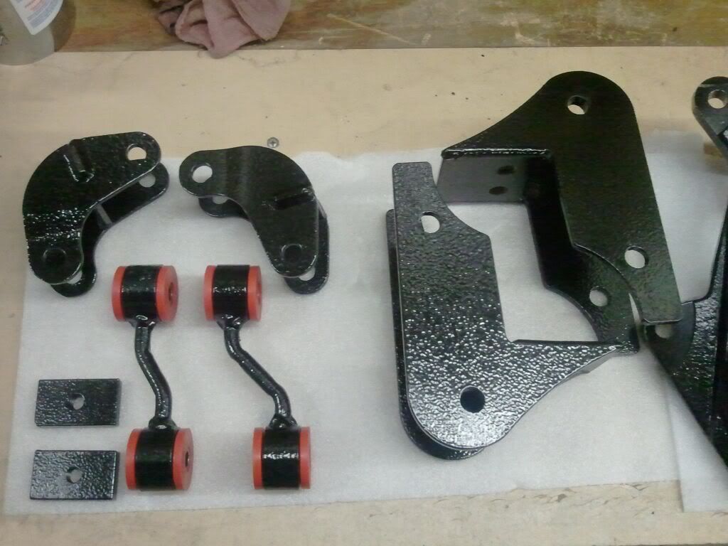

rear djm hardware kit

kinda long day did all the rear kit today ie trailing arm relocators/shock extenders/springs/djm bar/new endlinks and spohn panhard bar and bumpstop bracket. Truck feels perfect now around corners.
---------- Post added at 11:56 PM ---------- Previous post was at 11:09 PM ----------
bumpstop bracket cut with new short one installed and belltech 5305 coil
spohn bar vs stock bar
Rear djm swaybar along with shorter endlinks
