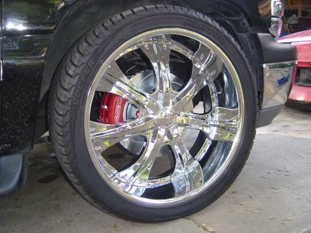

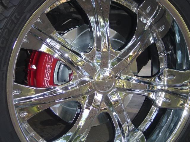

Now I have to find some time to install it. Nice looking kit. I went with SSBC because it was the only kit I could find that would fit behind my wheels. Even though the wheels are 24", you can see in the pic that my spokes start to curve in towards the lip, so the caliper from the Brembo kit I wanted hit the back of the spokes.

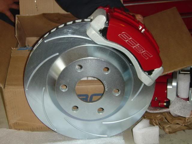

SO, since I've dealt with SSBC in the past with good results, I went ahead and ordered the only one they had that would fit. The kit came with 3 piston calipers, 14" zinc plated slotted rotors (stock is 12"), stainless steel braided lines to replace the stock rubber flex lines, all necessary hardware, and instructions. Here are some pics of the rotors and calipers:

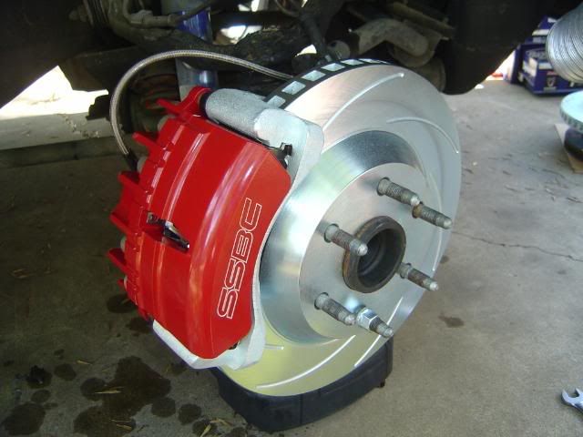

I'll be too busy the rest of the week, so I probably won't get a chance to install them till Sunday or Monday. I'll take some pics and do a write-up of the installation for reference.
