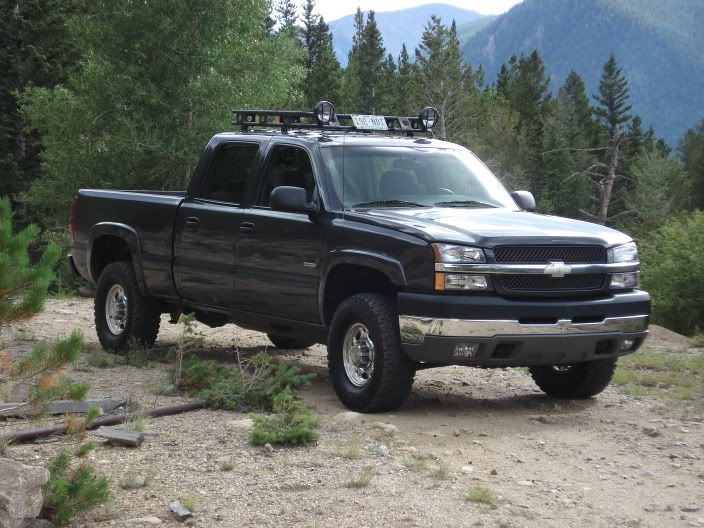

OK on to the stripping. there is a piece of chrome with plastic/rubber on the doors does this come off with a heatgun also like the emblems?
I noticed some dont have it..
see picture to see what i'm talking about
Just wait for a warm day and they will peel right off, hit it with some goo gone if it leaves some residue but my brother did his duramax in about an hour with a hairdryer
Will make the truck look 100x better.

i used hair dryer and wd40 w/ a towel. took 2-3 hours, but i live in colorado, and did it on a semi-chilly day. at the time i didn't want to use goo gone because i was worried that it would take off the paint. but i guess it doesn't.

are you guys talking about the "molding" on the side just about midway up the doors? if so, some of you guys please post your pics of it done, so i can see how it looks!
