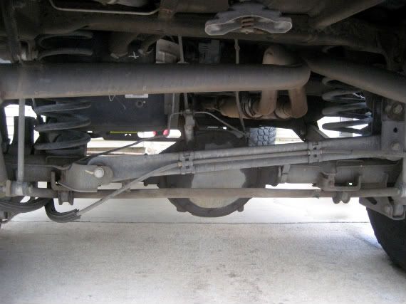

thanks boost. yes i do have 35" tires, it is only 2 wheel drive which i think takes out the problem of front diff. i have gone up underneath my truck and looked for problems but cant visually see any problems. my main idea was to take the lift off and put a lower kit. but wife wants to keep it lifted so now i gotta find the cause for the hard jerking.

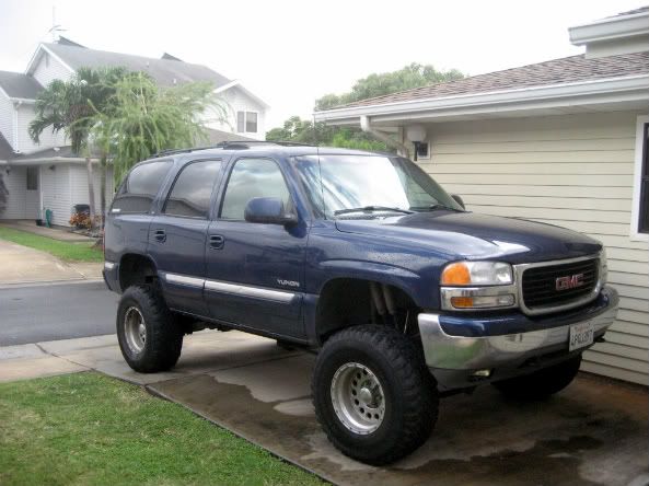

here are some pics. as stated before 2wd
the shocks are suppose to be chrome but its been rainy

Looks like the tie rod is fvcked up on the pass side, I'd look at replacing them with some high quality pieces like Moog or Napa Premiums.

really?! how can you tell? would i feel it in the steering? maybe that is what i have been feeling?

The boot looks pretty worn and from what you've said could be one of the contributing factors for your wobble issues. Check these guys out for a burlier replacement if you wanna keep the truck
tie-rod-kit
http://cognitomotorsports.com/store/page27.html
I'm screwed because I'm not lifted so I have to build my own, these trucks have some tiny ass steering and it bothers the hell out of me because I'm fairly rough on vehicles. Would be a good idea to check the pitman and idler arms for play as well as the sector shaft coming off the steering box (attaches to the pitman arm).
