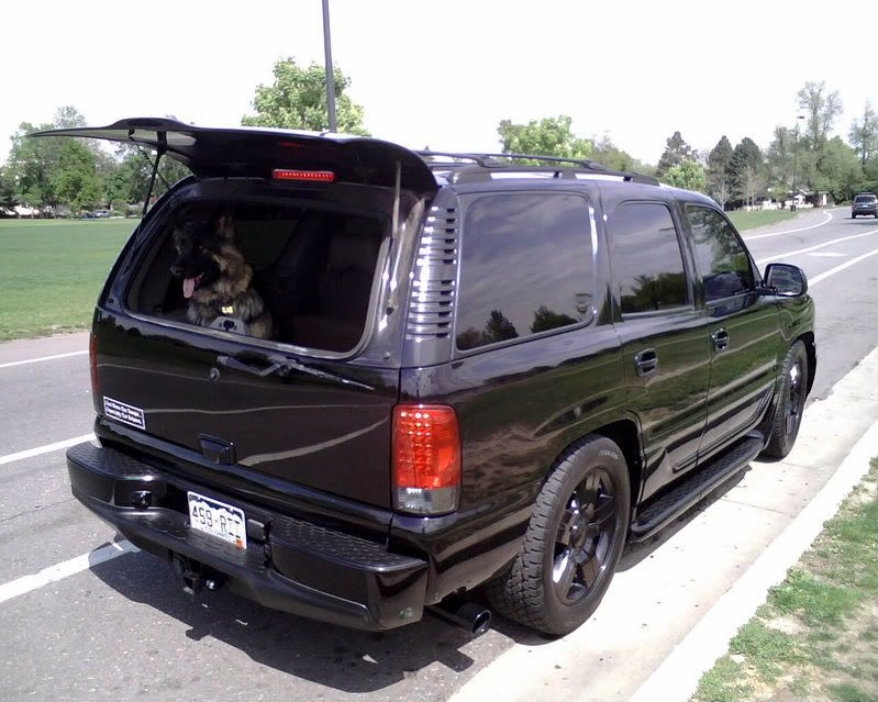

I went with the pro comp (made by cooper) all terrains 275/55/20. Ridiculous wet and snow traction, nice and quiet with smooth handling and they aren't too aggressive which was key for my application
I sell almost every brand of truck tires and this is what I bought, cooper makes a badass tire.

Boost, thats about pefect, I have never seen those tires. Is that size of tire the same overall size as the 265/70/17's? I want to stay the same overall size.
Any more pics of close up from the side?

I can sell you both, pm me which wheels you want and I can get you a quote tomorrow at work. My parents still live in sioux falls so I'll give you the cold as sh*t midwest discount lol. Here are some more pics, they are slightly taller than the stock 165/70/17 depending on brand
