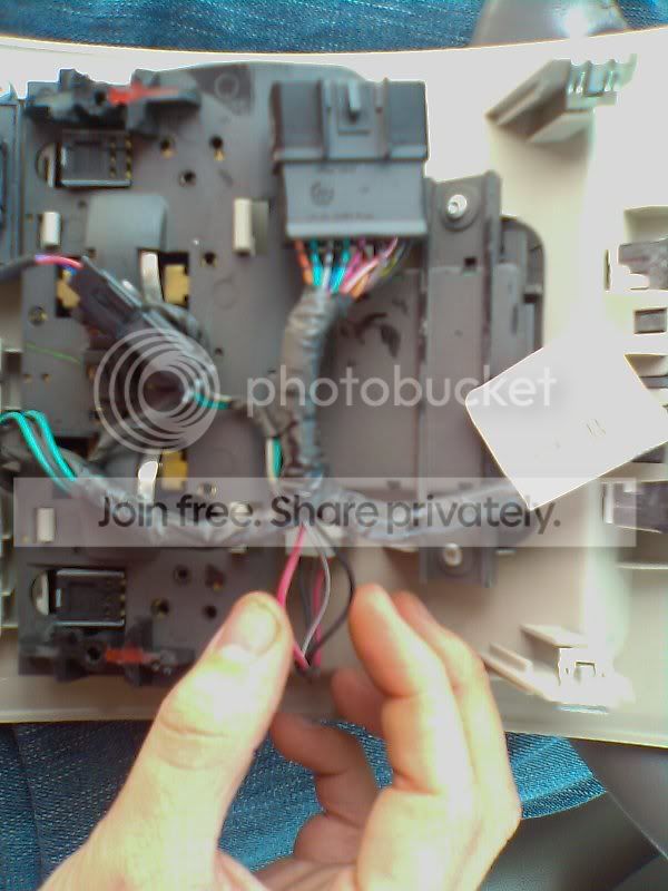

hey guys i have some pics i took of under the overhead console that has homelink and dome lighting. my question is for wiring in my radar detector, is this pink wire -- power (pictured) and the black wire -- ground (pictured)
suitable for ignition power?

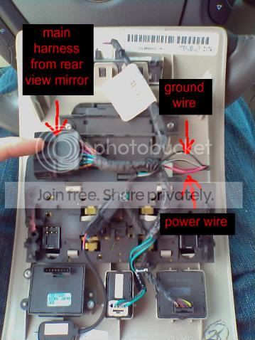

another picture for reference..

just brainstorming here::: won't that keep your radar on all the time?? Don't you need a ACC wire to tap into??
S.V.T.
Apr 12, 2008
174
if those are indeed the correct wires (haven't installed yet will tonight most likely) and they're wired for the power of the rear view compass/ dimming mirror, they would be ignition power.

ok so that is not the main harness to the rear view mirror as i found out.
i pretty much gave up with splicing into wires.. i just don't like that idea.
however, i am running power from the PDM fuse that controls home link which should be ignition power.
i do have a question:
WHERE is a suitable ground under the dash?! every metal screw has to go into plastic which then goes into metal!!! :cuss:
